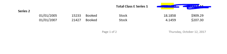

I'm using the following chunk of code:
       Document doc = Document.Load(inputFilePath);
    using (Stream reportDocumentStream = File.Create(outputFilePath))
        doc.Save(reportDocumentStream, Docentric.Documents.ObjectModel.SaveOptions.Pdf);
PDF outputs, but footer is not displaying correctly. It is not centered and is missing some of the data.
Attached are the outputs.

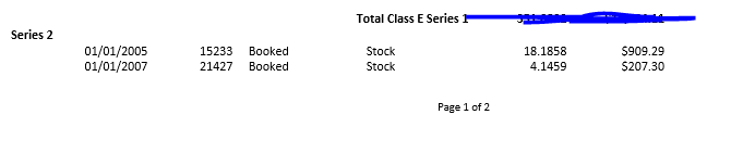

I already had that version as another one of our employees had requested some group by and additional xpath functions that you gave her this version for. Version 5.1 (5.1.18.1327) correct?
I'm attaching the word document that is not converting nicely.

The problem is the currently version of Docentric Toolkit doesn't properly resolve custom tab stops style inheritance. It hasn't been confirmed yet, but we will most probably fix this immediately which means that if this feature gets a go, the fix will be ready in a week.
In the meantime you can very easily solve this by removing unnecessary 2 tab stops from the paragraph in the footer, as shown in the attached screenshot.
Let me know if you control the templates and can use this technique.
Regards, Jure Leskovec
