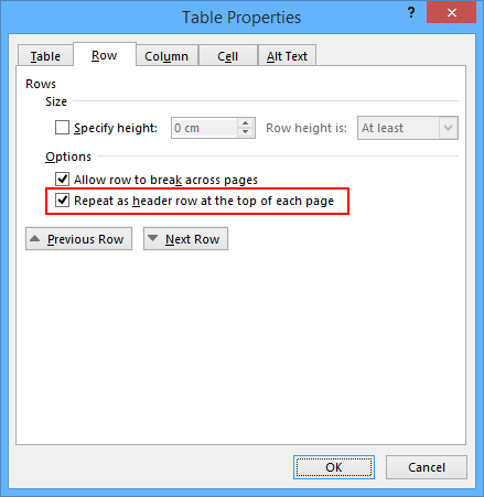

If I understand you correctly, you would like to create a template that would render a list of some objects/entries in the form of a table (each item in a separate table row) and in case the resulting table doesn't fit on one page, you would like the header and footer rows to be repeated on each page? If so, then you can achieve repeating the header row(s) by checking the check box in the table properties for the header/first row (see the attached image) in MS Word. Footer/total rows cannot be repeated this way and I'm not aware of a scenario where this could make sense. In case you also need to repeat the footer row, could you describe your scenario? Maybe there is a different solution or workaround for it.

Secondly, what you have described helped me to solve my problem.
I meant that there is some other data that has to be repeted with each page, I have used Word's header and footer section for this problem. Thanks!
