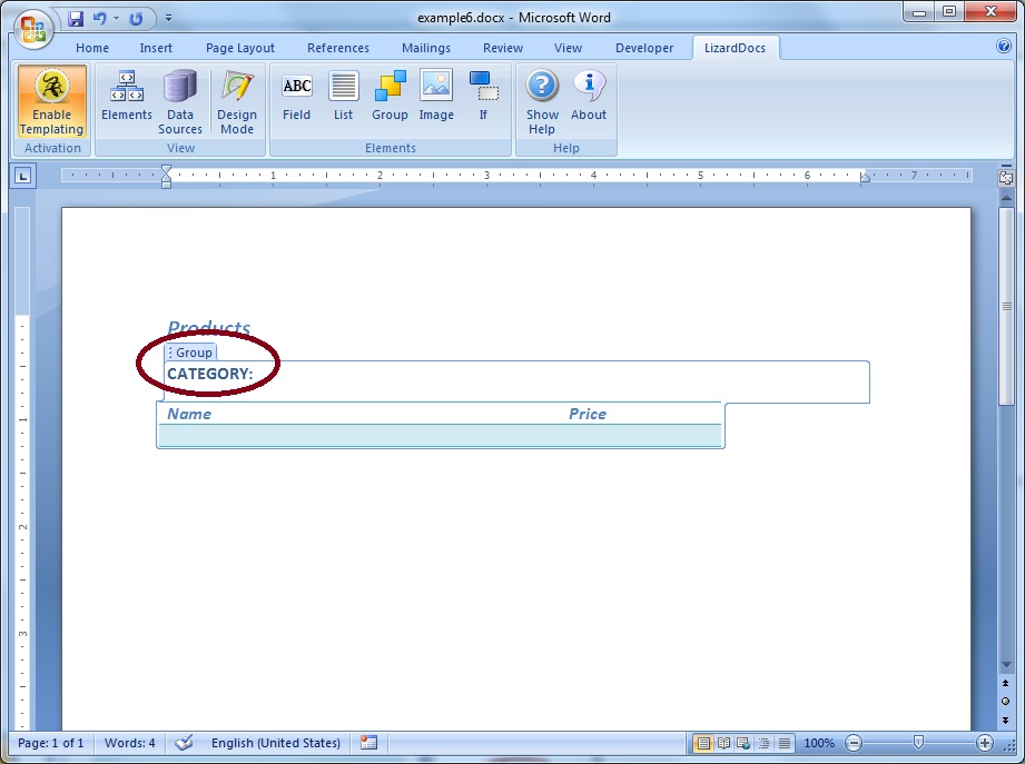

    Add LD Group element to the template in a way that
    the whole Word table with label Category are comprised:
    Define its property Binding Source to default that means
        IEnumerable<Product> and leave the Path property empty.

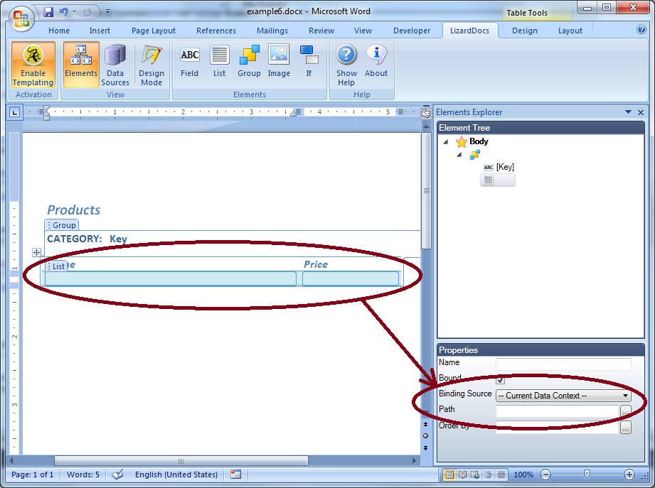

    Also, within Group element a List element naturally found its position
    in order to be bound to a singular group:
    We embraced the whole row within List element. Binding Source property
    is set to Current Data Context whereas Path property of the List element

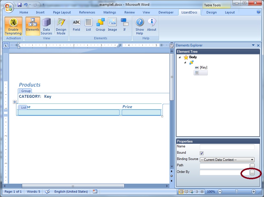

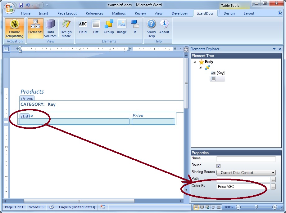

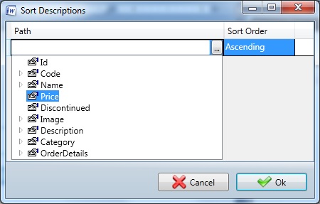

    is left empty. Next, we have to sort each of groups of products (grouped by group
    key which is name of product category) by product price. This is defined with Order
        By property:

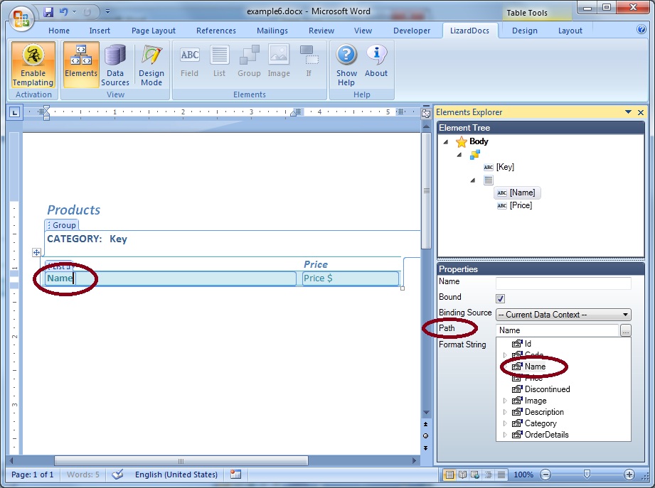

    Now, within List element insert right Field elements bound to product
    name and price. Field element bound to Product's
    property Price should be formatted as a currency using
    Format String property (about formatting values you can read
        here):
