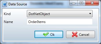

There is always a default data source defined on a template. You can't delete it nor you can change its name. This is because the report has no meaning without at least one data source. If you want to add additional data source, click the "Add" button in the "Data Sources" panel. The "Data Source" form will show up where you can set the name for the new data source.
After you enter a unique name you can click the "Ok" button to add the data source to the list. Similarly, you can edit an existing data source by pressing the "Edit" button. You can also remove an existing data source but the data source must not be a default data source nor used as a binding source by any tagging element in the template.

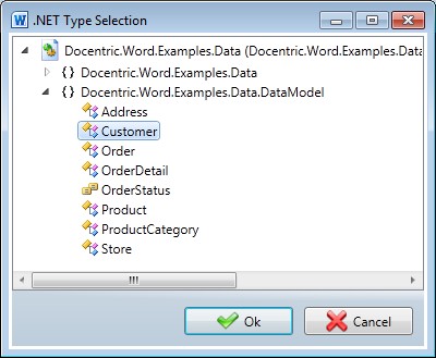

- In the Schema info panel click the Import Schema button. This will bring up a file browser where you have to select the .NET assembly file containing the target .NET type.
- After the assembly selection the .NET Type Browser will show up. It shows namespaces and all public types of the selected assembly. Select
the correct type and click the "Ok" button.
- If you want the currently selected data source to be a collection of objects of the selected .NET type, set the .Net Type Usage property to "As Collection".
In this case the report engine will expect an object of type IEnumerable<Customer> and not Customer as a value for this data source.
Make sure to always check the .Net Type Usage property. Invalid setting will always lead to errors.
- After the schema has been successfully imported, the .Net Member Tree panel shows the member tree of the imported .NET type.
